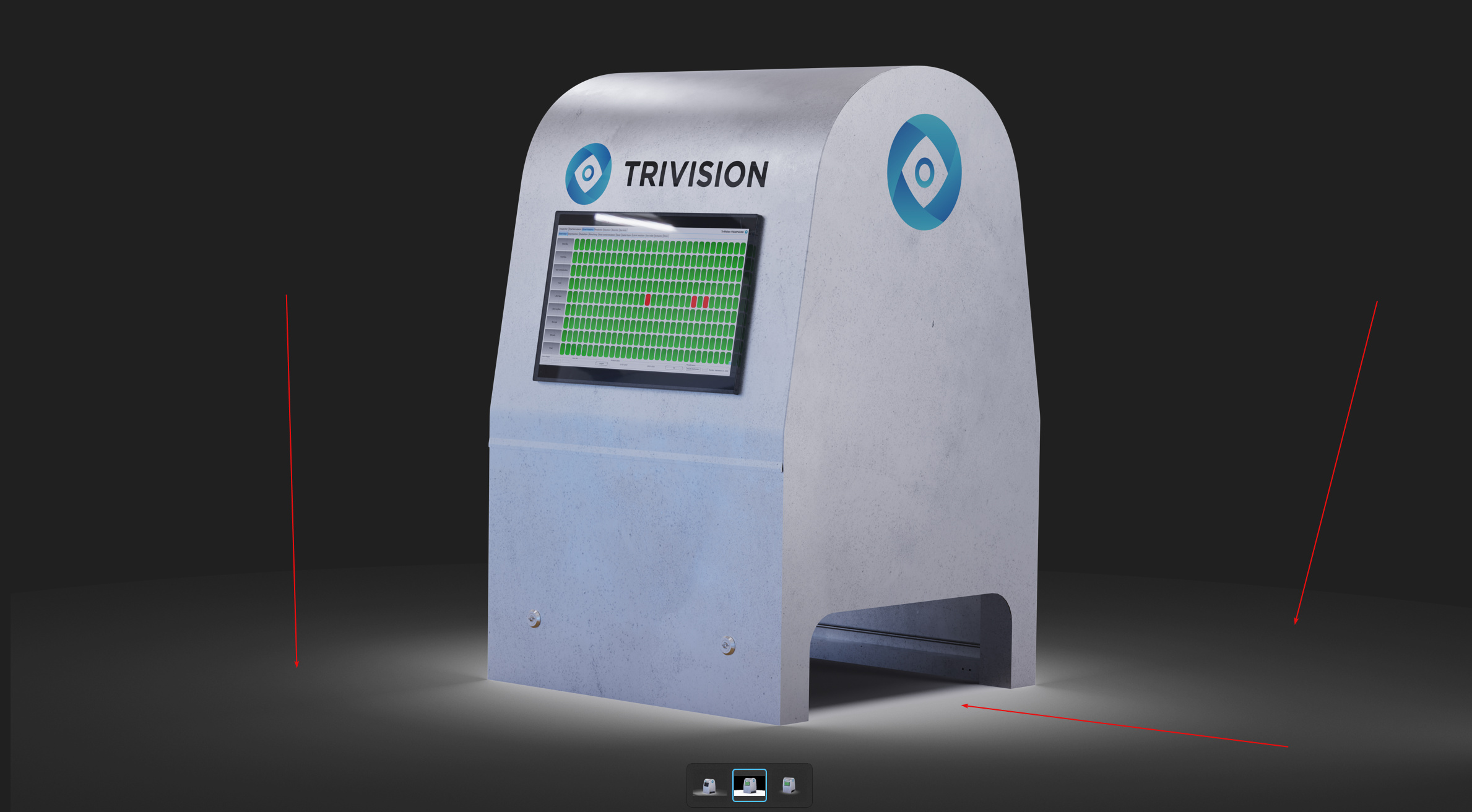

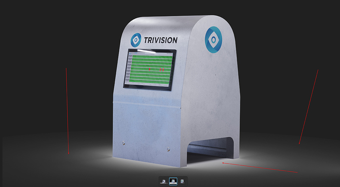

I wanted to know how is it possible to get rid of this white fog in my PNG (transparent) image. On a white background it looks amazing, but when the background is darker, then it can be seen well, which is not desired. I would like to keep the shadows, but the white fog does not look good.
I can edit the image in post process, but that workflow is taking too much time.
Any help would be appreciated! Thanks in advance!

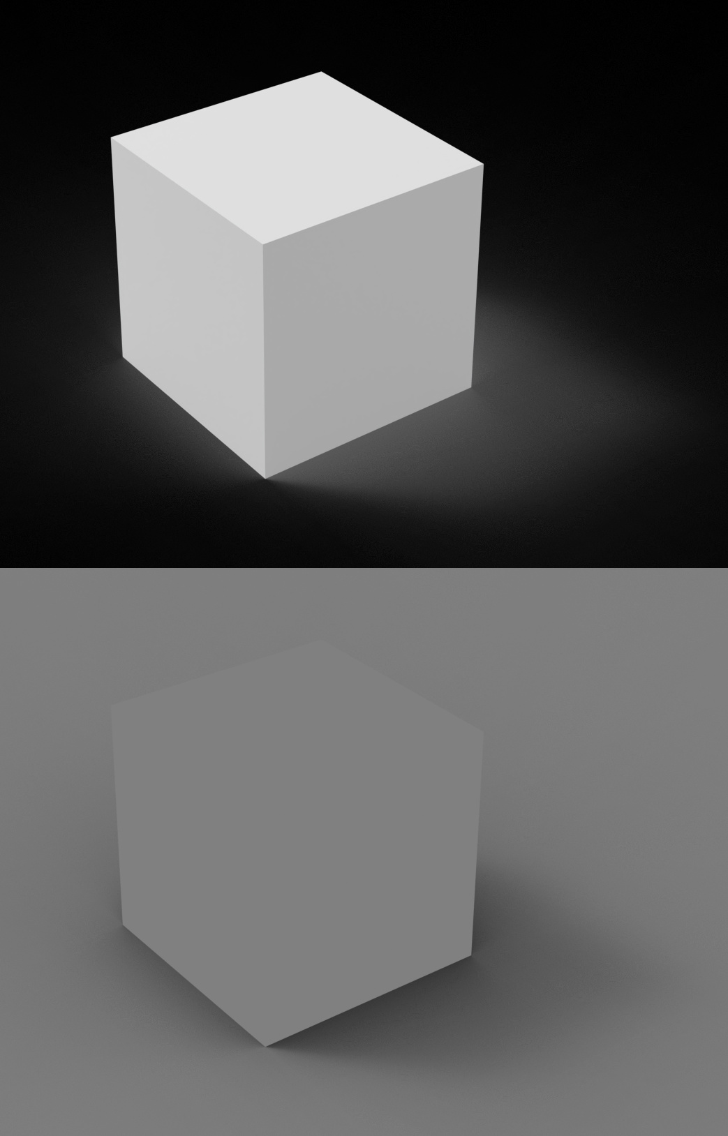

I was playing around with a cube but I think that white fog you see are shadows as well. They just look white since in the normal process they should be f.e. in a separate layer on ‘multiply’.
Like this is the cube and below is a render pass from the ‘shadow’. And I guess that will be the same with your render.
I’m just not sure how you get the shadow pass to be just the shadow transparent so you could simply put the layer on multiply regardless of the background colour you will use in the end.
But maybe this helps you a bit since it’s not really some kind of light bouncing off but the shadow you actually see. If I use ray mask I can get the shadow to be light like it should be but what I doesn’t really work for me is having the object without the shadow.

I have tried to change the BG color, but the white is still there.
Regarding Photoshop - I do not have it and I would assume that post process and “fine tunning” is up to everyone’s preference. Thus, I would expect the rendering software have full control over things like these.
